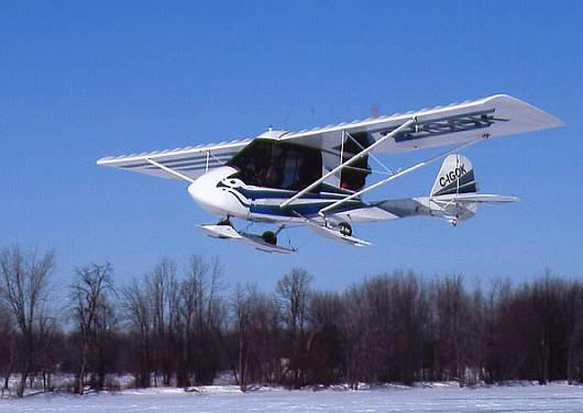

I was/am still wanting one of these:
$35,000 for the kit, and very inexpensive to operate. Not as fast as some of the competition, or as pretty, but affordable! I have seen a few in person, and they are quite stoutly built. Best part, you can choose to operate on wheels, skis, or floats, as all are available for it. No limit!
The website for the local distributor is kinda cheezy, but all the specs are there: www.challenger.ca
The local distributor (Brian Quickmire) seems like a VERY nice guy. I emailed him some questions on the Challenger a while back and he is very thorough in his replies. He is clearly an enthusiast himself :)
The challengers are awesome for "low and slow". Take off performance is amazing on them and I think they look way nicer than the Beavers.
