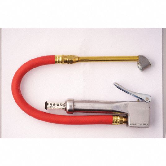

How about gauges attached to an air chuck. I keep promising myself I'll buy one but instead I add air check, add air check, release too much etc etc.
I just use 2 gauges and take the average. They are both within 2psi of eachother so I figure for street use it's good enough. One is a cheap pen stick type and the other a cheap battery type Accurist digital gauge.
Yup, even if they're not accurate, they're handy to get in the ballpark. My inflator has a built-in readout so I just over-inflate by 1 or 2 psi and then use the bleed valve on the Motion Pro to bring it down to the pressure I want. A quick press on the bleed valve button can drop the pressure by as little as .1 PSI per squirt, so accidentally releasing too much air isn't a problem.

One you recommend?
Meh. I have a PA one that I had to replace the gauge on as it had gone way off and a milton similar to this. They are ok but not great. If I get another one it will be digital. It will probably be dead every time I want to use it though as most cheap digital things have high phantom draw and I'm not spending hundreds on one.
