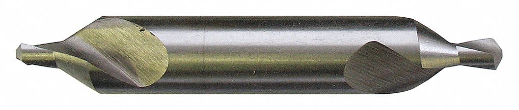

If you're going to be drilling fasteners you're gonna want the STOUTEST and sharpest drill you can get. Drills flex and wander... that is BAD. You may want to start the hole with a "center drill"
