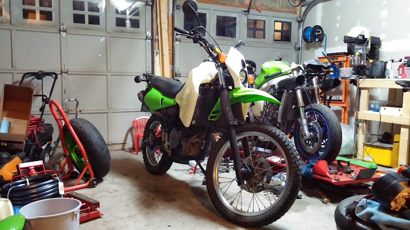

finally got to spend a couple evenings with the bike. Getting close to sending the frame off for work.
leaning towards powder...
You know just because it's called a dirt bike it doesn't mean that it's suppose to have the dirt ON it but ride IN it lol.
I haven't seen a dirtier bike in a long time and the fact that you've removed the airbox with that pile of dirt on the engine scares me. Before any work is done on a bike it should be washed properly ESPECIALLY a dirt bike! I know your restoring the bike but you'd have a lot less mess and an easier time finding the nuts and bolts if you even had just hosed the thing off. Now the motor possibly needs to be torn down to get all the dirt out of it depending on how careful you were when removing the subframe/airbox.
Heh. Point taken. The bike actually didn't look that dirty until I started taking it apart. Most of what you see on the floor came from hidden cavities in the swingarm. I even found a whole pinecone!
When that pic was taken the carb and exhaust were still on so the motor so I doubt any dirt got into the valves. I'm not too concerned either ways though because I'm installing a 785 kit to cure the KLRs notorious oil consumption issue which this bike has a fairly bad case of.
Anyways, I'm keeping an eye out for power washers now :)

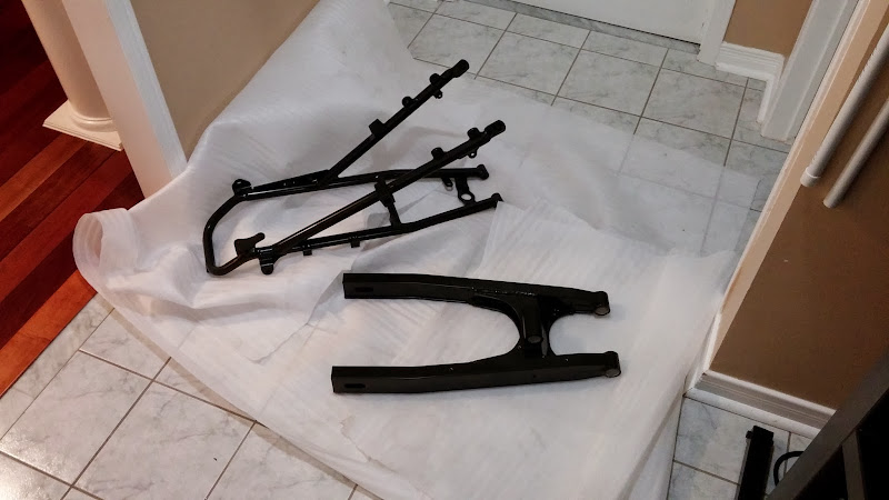

A quick update to this old thread. I ended up powder coating the whole thing with a basic medium gloss black (forget the exact name). I took the frame to Johnny's new location. The parts came back looking good and show no signs of wearing yet.
Before
After
