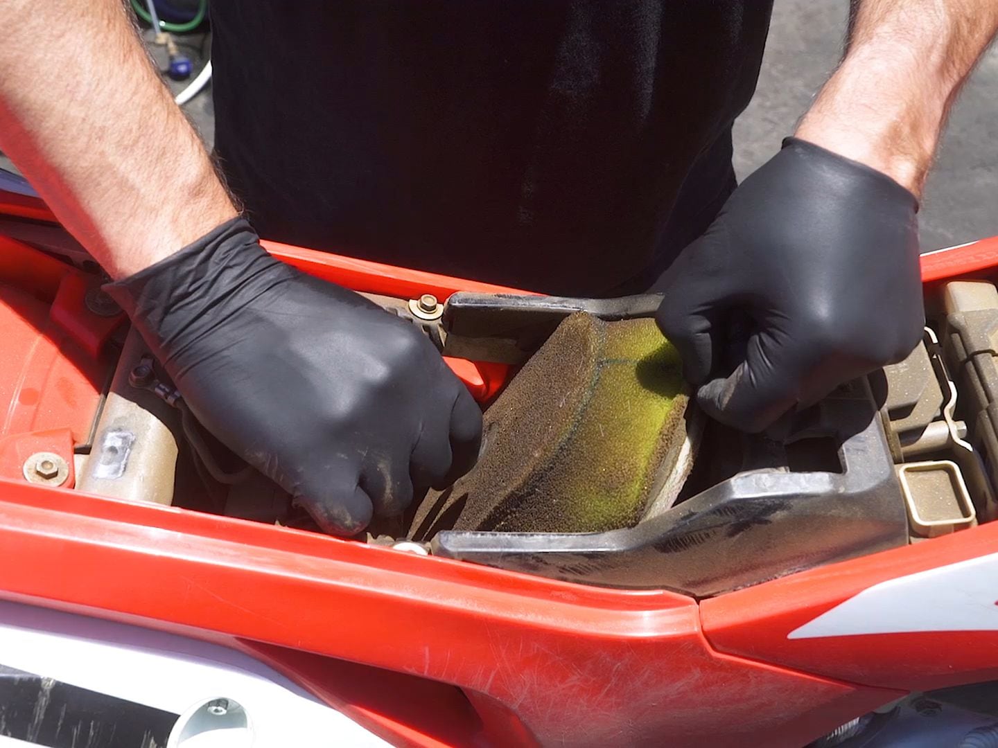

Big fan of the green no toil and twin air filters. MX I clean my filters every ride and trail riding every couple of rides. I use oxi clean when I run out of the no toil cleaner. I get a long service life out of my filters, hang to dry and lightly oil. No wringing which leads to tearing the foam filters.
Do you just gently swish it in a sink of soapy water? Maybe periodically giving it a gentle squeeze?
If your asking me about the no toil....then yes pretty much.
1. rinse the filters from the inside out under the tap to get the heavy dirt out. You don’t need to go crazy with the water pressure here.
2. fill a bucket with water and the no toil cleaner or oxiclean. Toss the filters in for 30 minutes or so to soak. I may gentle move them around to agitate them and get some of the tougher dirt out.
4. rinse again from inside out. They should be clean at this point otherwise go back to soaking them in the bucket again.
3. Hang to dry.
4. I put no toil in Tupperware at the start of the season and then dip the filter in lightly to cover it. You only need a thin layer. Don’t go crazy and soak it. If you do you will end up having to squeeze out the excess which leads to tearing the filter.
Or it'll drip down and leave a green mess under your bike. Then you'll freak out the next day thinking you've got a coolant leak.
Been there. Done that. Got the T-shirt (which I used as a rag to clean up the mess).

After rereading the posts I have one more question (I lied) or perhaps a clarification ( I didn't lie...?)
Are you guys just dippiong the outer surface of the filter in oil to coat it? I was trying to impregnate the whole thing, going so far as to pour it inside the filter as well. Is that overkill?
Underrated
Put enough oil on it so that it is completely covered, but won't drip off. When you are done, you shouldn't get very much on a paper towel if you squeeze it gently."Gentle" is the key word.
I always have a couple of air filters: one on the bike and one oiled up and ready to switch in.
I just use a couple of tablespoons of filter oil inside a ziplock bag and then work the oil into the filter while it's inside the bag.
That way your hands don't get all messy, and when you're done, you can leave the filter in the bag until you're ready to install it. When you take the old, used filter out of your bike, after washing it, you can use the same ziplock bag to re-oil and store, so there's very little wastage.
If I was more organized, I'd have three or four filters, then clean and oil them all of them at the same time to cut down on time and use less detergent.
But I'm not that organized.
