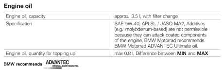

Unfortunately the manual only states 5w40 :(

Have you used the SPECIFIC oil listed in the manual? Adventec? (it looks like Adventec is made by Shell)
