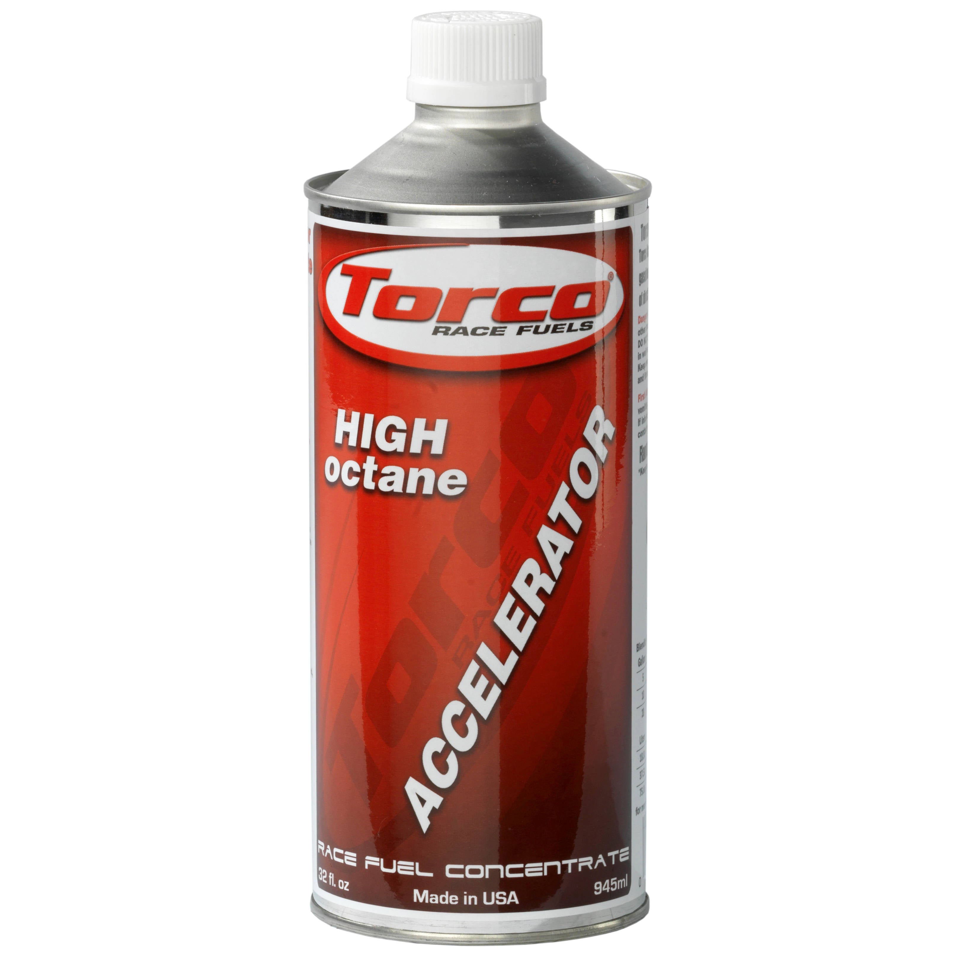

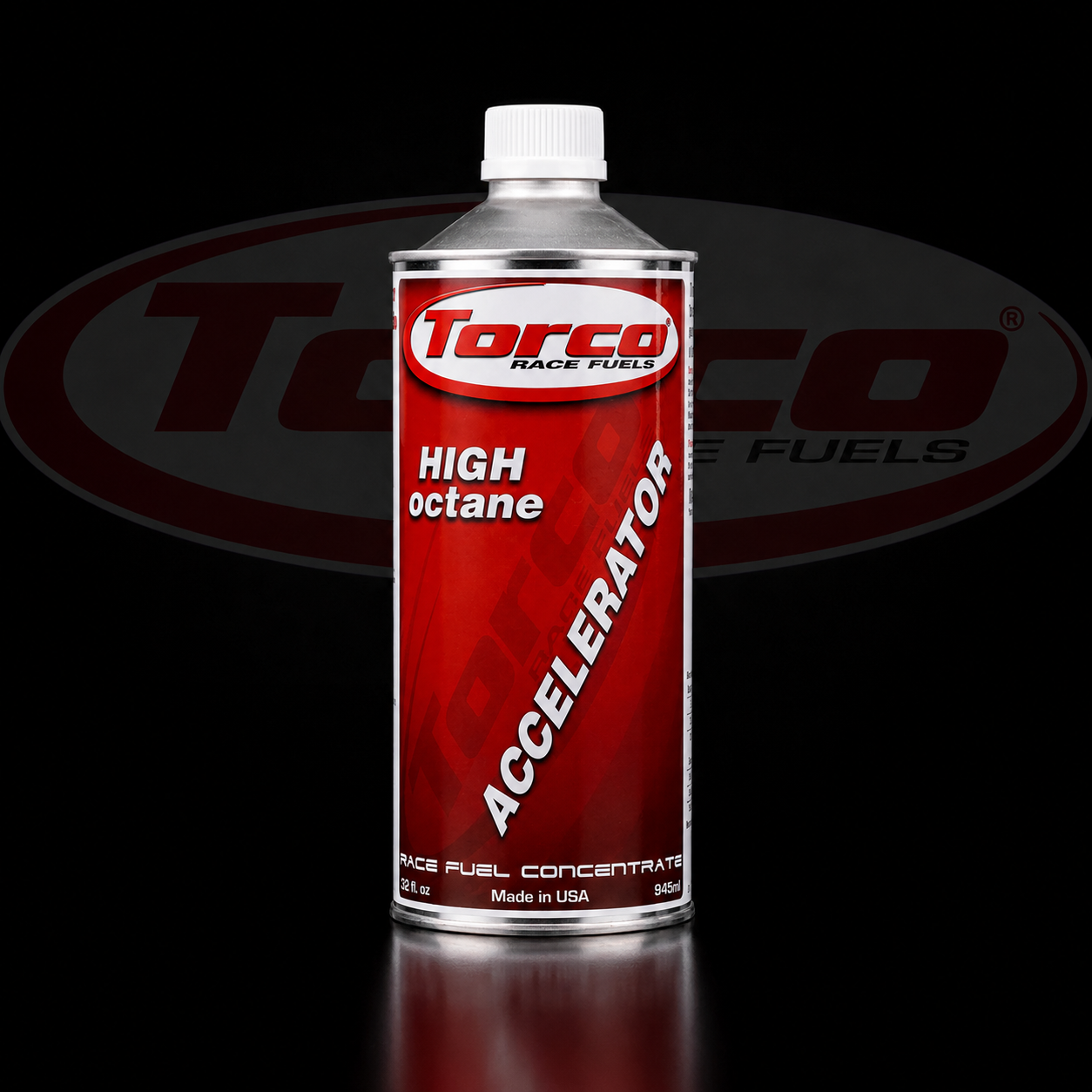

Ended up getting a bottle of this from CT:
Some of the guys on Thumpertalk said it worked well on 4T thumpers. One bottle does 45L of gas, so it should last us a few tankfuls.
I looked at the same stuff at the local auto parts store. Written in the fine print: "Not for use in vehicles equipped with oxygen sensors." or something to that effect.
I'm no expert, so do your own research.
