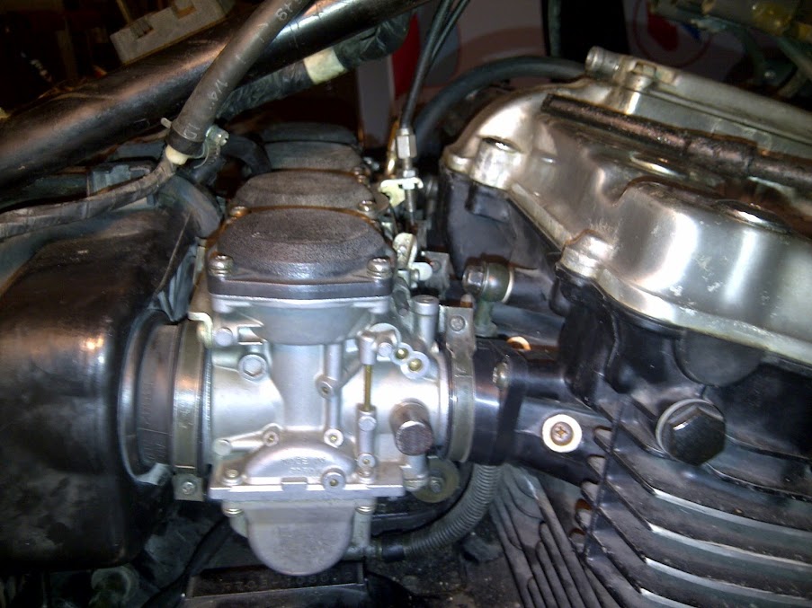

Carbs back in, throttle and choke adjusted and working. ;)
I also installed the chain, now for wiring....
