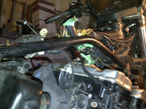

... Finally had some time to work on her last night.
The engines in the frame (just sitting on the frame for now).
It doesn't look like it but, it's a ridiculously tight fit, took the better part of the evening (and some skin from buddy's knuckles).
next time you have a bolt like that and you are using an extractor you should get proper torches heat up the bolt untill its red hot and douse it in a cup of cold water to shock treat it. This will actually make the bolt shrink to slightly smaller than its original size and break away most of the fused metals and should come right out with ease!
Thanks for the advise, I did heat it with a propane torch but I was very concerned with applying to much heat to the aluminum block...
Ok, so I managed to get the mounting bolts back in, tougher than I thought, especially trying not to pinch the many wires for sensors etc.
Coils back in and re-wired (green tape is labels, I'll remove when I know she runs. ;)
... and a lot more wiring ahead;
but first, carbs to be cleaned, new boots etc.;
