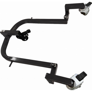

I'd be looking for one of these............
Have two of these. Works great.
A buddy has a centre stand in the our storage, hate it. Unless I don't know how to use it moving it around the bike rocks front to back depending on which way you push it.
Yeah I was also wondering how you are supposed to avoid that on those centre stand dollies

This one actually has locks on the casters which makes sense. My buddy's does not. Further the rubber has come apart from the dolly.
