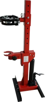

So, I bought the second spring compressor that I mentioned in my original post (This one).
It is sturdy as heck. Unfortunately, the jaws are too thick to grab more than two of the coils of the spring on my bike (87 CBR 600F). The rest of the spring is too tight against either end of the shock. This means that while I can compress the middle part of the spring pretty far, there is still too much tension on the remaining outer part of the spring for it to make a difference.
I wonder whether the same will be true for the other type of spring compressor.
I decide to try ratchets, which I have done with my dirt bikes. I quickly found that the length of the spring in the unit is way too short for me to figure out a way to use a ratchet…with my dirt bikes the length of the spring is so much longer that it’s not a problem.
It seems the proper device looks like this :
And, it’s off to Amazon I go to look for one.

If you've removed the shock and want to bring it by Mississauga, we can try my strut spring compressor which works great for my cars. Never tried a bike shock in there, but if you want I can dig one out and test it.
