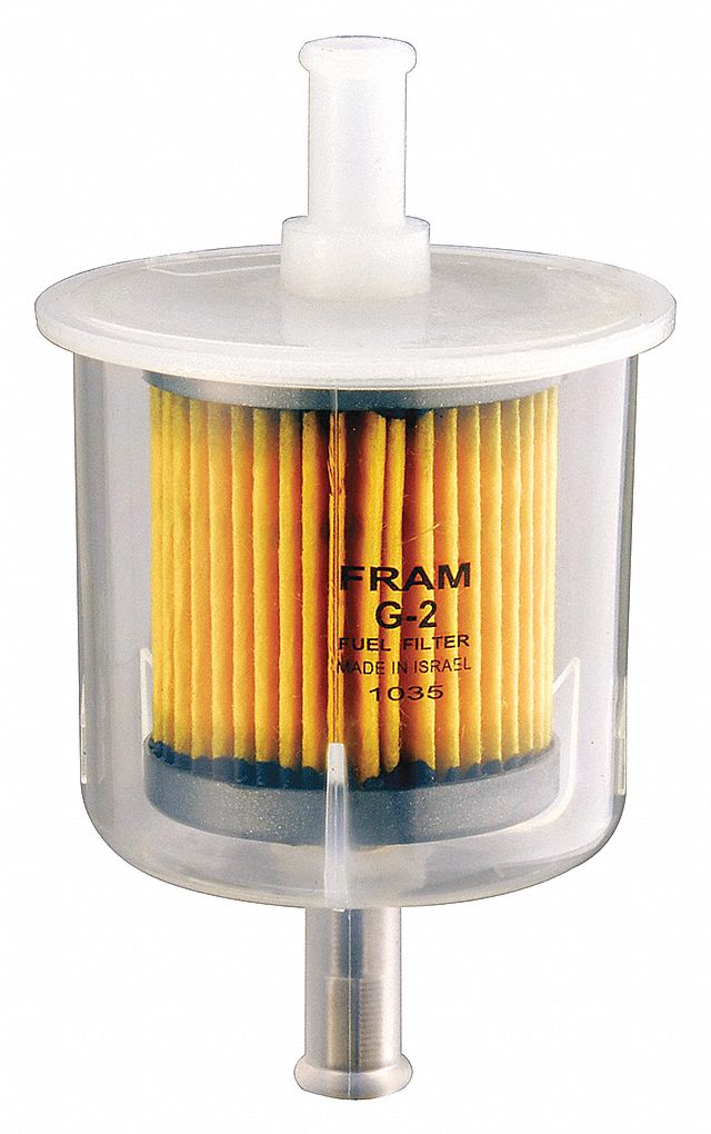

I like this style for cheap and cheerful (~$5). Depending on location, wrap in tinfoil to insulate it. According to store specs, the top one is good for 80 hp. Tons more surface area than the flat disc filters. The fram one I showed is bigger (5/16" hose, ~2" x 4") and according to fram is happy on many 300 to 400 cubic inch engines.

Bigger is better until space is limited. I had the first one GG showed. Might go with that again.
Where did you find the "store specs" GG?
lowes/rona/wherever. I couldn't find a manufacturer page or I would have referenced that. I just searched for inline fuel filter. I use the small one on the mini which is making over 100 hp without issue. I may go larger for the replacement just because I can, I have the space. You don't get to run at full throttle for that long anyway so I've never felt that it was starved. It may be different on a track, but that's not where I am.
