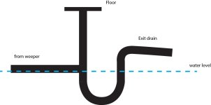

Now my only concern with the new config, I had to push down the p-trap because the weeper connecction is lower then the exit, which forces the water level in the trap up, high enough it's level with the T fitting going into the weeper connection. I have dumped a few buckets of water down there and the level stays so I am guessing the trap is working and forcing the water to the exit. Unless the water is going back down the weeper and just filling up the rest of the system, not sure since it stays level, and I sure there is a slope built in since it works on gravity.
Here is what I am talking about.
How much water is going into your floor drain? If you have a lot from above, it fills the weeper before it goes out the drain. Most floor drains don't have a lot from above unless you are in the middle of a major event (eg burst pipe). Ideally exit pipe would be below weeper so weeper sits empty instead of full but you are way better than you were before.
Nothing really. It's just there to have a floor drain. The little pipe you see in the photos above is a line from the laundry machine tap to prime the p trap. Other then that, that's it. The floor drain will be capped.
Yes I agree as well. Unfortunately I cannot move the exit or the weeper points. But at least now the water from the weeper has someplace to go instead of emptying under the slab. I've looked at it several ways an I cannot think of a different way to solve this.
I'm going to leave it open until tomorrow to see if the water level changes before I seal it up.
Good job @sburns. My only question is whether it would be worth to replace the cap with a check valve type system? In case water does get into the basement and toward the drain, it would allow it to flow out into the drain instead of pooling at the lowest point and increasing in size?
I would definitely install a bpv if I was into a floor drain. Very little downside, potentially huge upside. Although, with the weeper tied in, ideally I would want something before that connection as a weeper full of $#!t is not ideal.
Are you sure he's better off? I would think the weeper low point is at the connection to the existing drain, from there it's up hill. I'm guessing a couple of things will happen:
1) Sewer gas will move into into the house if the weepers have another connection to the sewers.
2) Anything draining into that floor drain will move to the weeping side instead of the drain side.
The proper way to deal with this is forming or buying a small sump pit to capture the effluent from the weepers, then use a pump to eject it outside or into the existing drain -- really no other way to make water flow uphill.
Another option would be to compute the slope on the existing drain then run a 2" ABS pipe beside until the level of the weeper is at the same as the drain.
I guess I will find out the hard way....hopefully not. 🤞
I put a clean out cap on this floor drain, so any gases will be trapped. There is nothing draining to there otherwise.
But if there is another point I am not sure.
