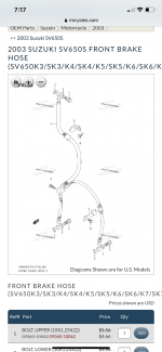

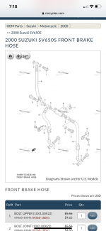

I don’t own a SV so can’t help you there but a quick look on a parts diagram and it looks like the routing is quite a bit different. I would probably try to find some lines made for your bike instead of messing with the ones for a 2003. 1A38CE9B-09CC-4874-B419-2A529DD1EA46.png7DF8EFCB-1892-4172-8C75-48234D2DC189.png
yeah I saw that parts pic. The ones im looking on ebay for the 03 sv650 are the race setup where each line goes from master to each caliper. I also found out the suzuki for those years all use a 10mm banjo bolt connection on master and calipers.
