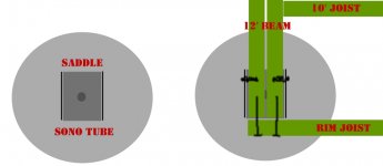

Maybe a dumb question, but if I’m building a frame directly onto sonotube footings how do you connect the corners if the tubes are at the corners? I can only see saddle type brackets that support beams lengthwise through them. I tried to find a corner bracket but wasn’t able to.
Your saddles go in the direction of your load beams (holding the 12' side), a rim joist goes the other way.
