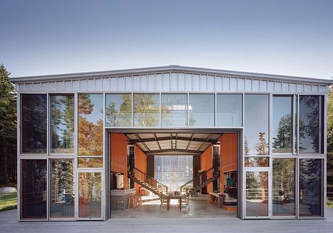

Have any of you designed and built your own home without the help of an architect and/or a contractor? If so, what was your experience like? Was it worth all the effort and time?
This probably sounds dumb, but I'm pondering the feasibility of buying some vacant land and building a home myself. And, when I say "home," I don't mean building an enormous 10-bedroom mansion worthy of Frank Lloyd Wright's Fallingwater. Rather, it could mean something as simple, relatively speaking, as converting a used shipping container into a home.
I really enjoy working with my hands and looking for a challenge. I have no architectural or building background (in the art/design field, though), so I think it's going to be an uphill battle--obviously. :rolleyes: Is this possible? Or, am I dreaming in la-la land?
For those that have done this (or are thinking about it), what books or courses would you recommend?
