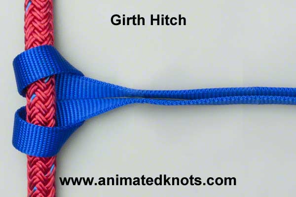

2" cam buckle straps. Replace the bed end with self locking hooks and the bike end with caraibiners. Climbing strap looped through itself around bars and carabiners clip to them. Cinch loose ends of straps through themselves tight against buckles. Done. Best 2" cam lock straps I've ever used were the branded Yamaha ones dealers sold in the 70s.
Been thinking about using carabiners for a while. Would allow you to use a lot less tension as you don't have to worry about it coming unhooked if it goes slack.
Exactly. Some climbing straps in a Girth Hitch on the bars and the carabiners clipped to them and you never have to worry about popping a hook. Plus there's less pressure on the bars than the single contact point of a hook, and they don't leave marks.
