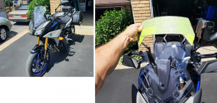

I cut mine on my metal cutting band saw, using the bolt on table that came within it.. Then sanded the edge working down to 1000 water paper..

Need a test ride report. Is it quieter, less buffeting?
And yeah, we knew you could do it.
Gladly...didn't notice any helmet buffeting at high speed but the biggest difference was a substantial reduction in wind noise in the helmet. Previously I would endure this crazy roar, that roar is now gone.
Shoulda done this a long time ago. The 2" taller than stock windshield I have on order will be used for long trips I suppose.
Yeah, once you put a larger windscreen on that moves the wind above your neck, you basically have to keep super-sizing it till the wind goes completely over and around your helmet to eliminate the buffeting. There's no in-between.
You basically only have two options: shortie to get clean air to the helmet, or a barn door to get a completely still bubble of air around your head. Most people do the latter, because they haven't figured out the former yet.

Done. Jigsaw. Didn't remove from bike. Chameleon inspired me to have a pre-cut poop. Very helpful…
Ive never tried a pre-work “poop” before working on my bikes. Interesting tip, how did it help?

Not sure how tall the other screen is but I can't stand looking through the sheild. If I have to look through a shield it's jig saw time.

I'm not a fan of the stock screen, I think I'm cutting it down now. Mine looks like someone cleaned the top 3 inches with a brillo pad anyway.

I'm good Iceman but thank you, my now-shortened stock screen is great and I had also (somewhat prematurely) ordered the V-Stream sport-touring which is 2" taller than stock, which unfortunately I probably won't use too often, if at all.
Now you need one of these:
CRAFTICS EDGE SCRAPER
