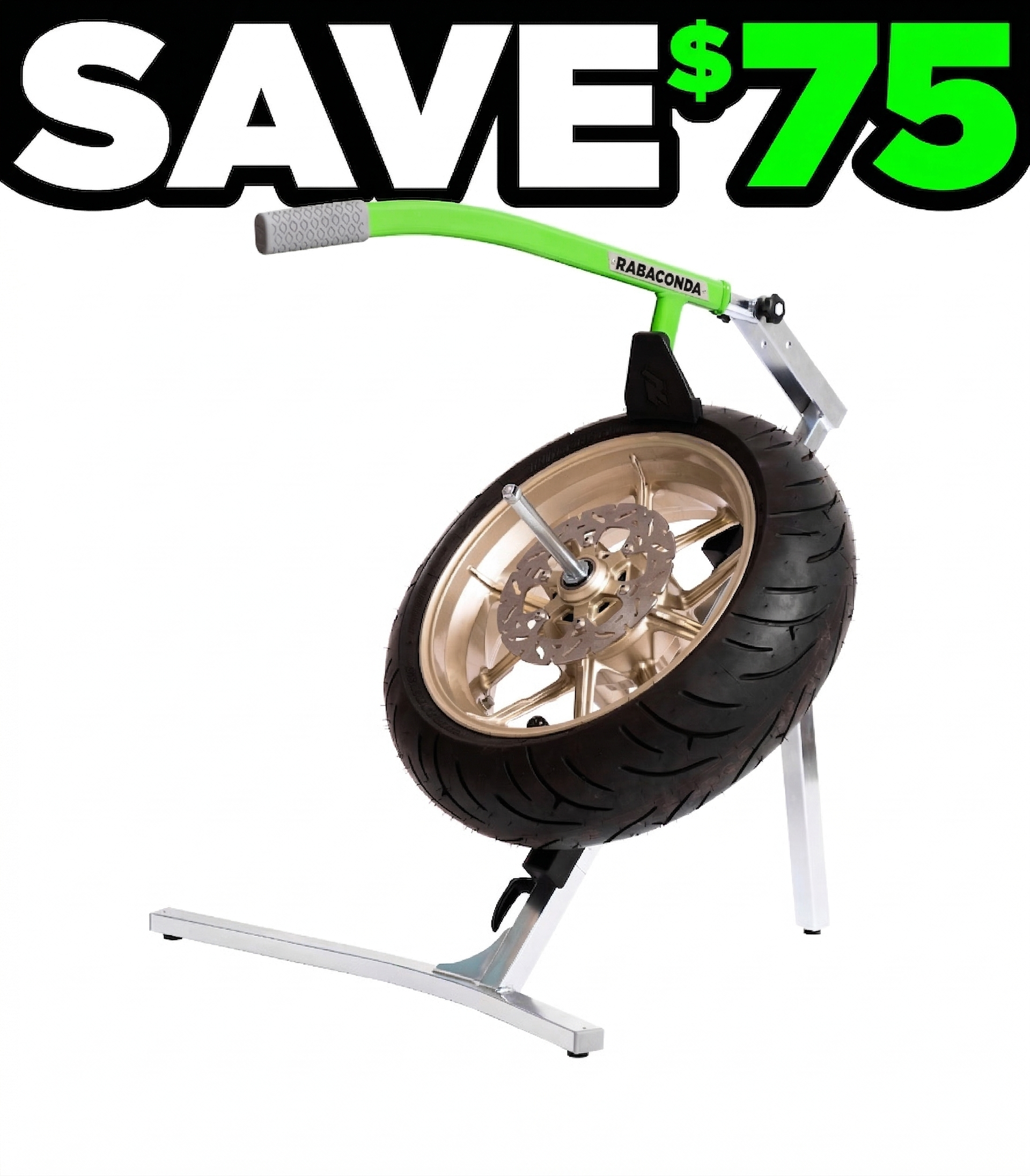

I'm not sure why I keep hand bombing tires when this is only a click away....(a nomar needs/takes up garage space that I can't spare)
Space was the reason I got rid of my Nomar. I just wasn’t changing enough tires anymore to hang on to it. That Rabaconda looks pretty slick though and would be perfect for sport bike tires. Sport touring, touring , cruiser tires get progressively stiffer and more difficult to mount though. Bridgestone and Michelin were always my preferred brands and one thing I noticed was that the Michelin tires were noticeably softer (both sport and sport touring) and much easier to mount.Something to keep in mind if you plan on changing tires with irons. Also, laying your tires on your driveway in the sun for an hour makes the job a lot easier. Anyone planning on changing tires for the first time, I highly recommend watching the Nomar instructional videos on YouTube. There are some really good tips that also apply to doing tires with irons with respect to where to put the lube and positioning of the tire bead in the wheel valley opposite the side that your working. Last but not least, always wear a condom, just say no, never push a Q-Tip into your ear, just use it around the outside of your ear and never,ever run holding scissors.
