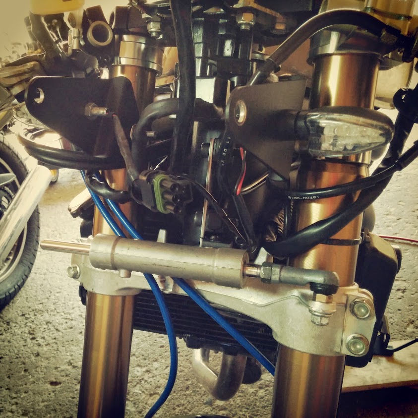

I've moved to a new garage with better tools and space. Started fabricating some more brackets and things with my MIG welder:
First thing, my speedometer cable bracket broke:
So I made a new one out of steel:
The bike was still feeling a bit twitchy after the steering bearing change, so I fabricated a bracket for a gsxr steering damper that came with my forks:
And with the steering damper on:
