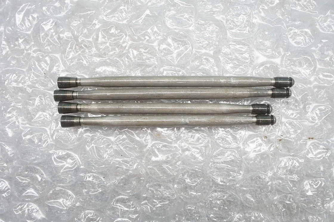

Stock ones:
Solid aluminum 0.375" shaft with hardened steel ends

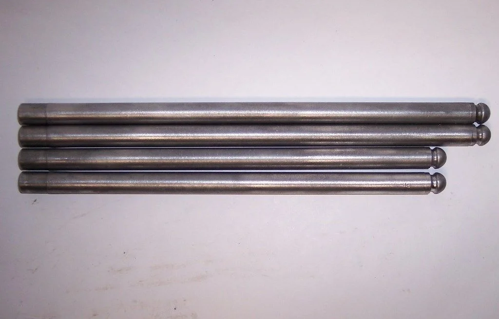

Chrome moly ones:
4130 Chrome moly 0.3125" dia 0.083" wall thickness (These aren't the ones I bought, I think these are Maney)

Stock ones:
Chrome moly ones:
