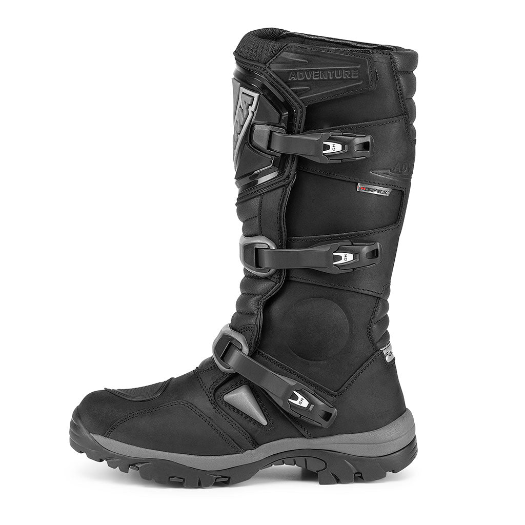

Shoes wise, I see lots of ADV guys using Forma, which I will have to try on.
Not sure about those. They look like they may not have support through the ankle. You are looking for an exoskeleton, not just a bit of padding. You want crash forces to get transferred around your ankle instead of through it.
EDIT:
Upon further review. Hell no. You look like a power ranger with very little benefit. They acknowledge they are shite and you should buy something better if you want protection. The ones they recommend if you value your ankles have the exoskeleton.
From link on Adventure boots:
"Due to the special lightweight sole design, these boots are not recommended for use with kick-start bikes or bikes with aggressive motocross style foot-pegs. These boots have limited offroad protection, and if you are a rider that mostly stands up when you ride, we recommend the Forma Terra Evo boots."
