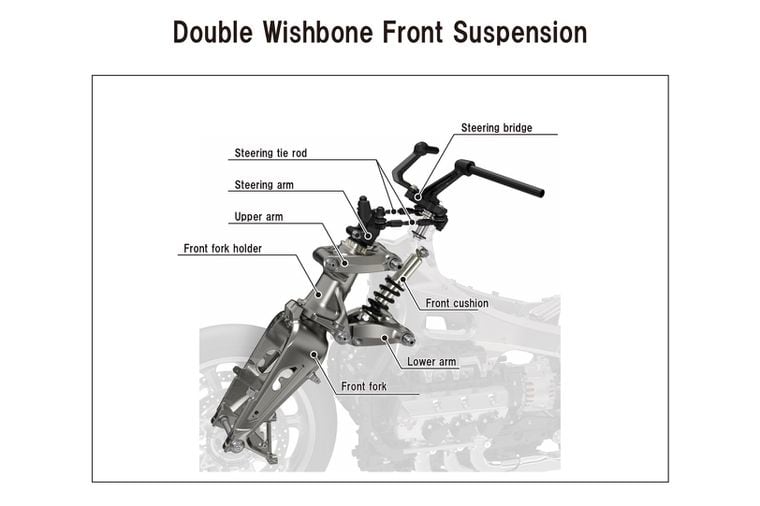

Adjustable pivot for the "control arm" allows the amount of anti-dive to be adjusted by moving the pivot up/down (parallel to fork centerline) and allows wheelbase (and rake angle and trail) to be adjusted by moving the pivot fore/aft (perpendicular to fork centerline). If it is a 90-degree angle between the fork centerline and the control arm at nominal ride height, it will act like normal forks (no anti-dive). If you raise the chassis-end pivot, you get more anti-dive. Note in that photo, that it looks like the angle between the fork centerline and the control arm is pretty close to 90 degrees. This angle obviously changes with suspension travel ... annoyingly, it will go towards anti-dive when the forks extend and towards pro-dive during compression (i.e. braking). The BMW models with Telelever have a really long control arm in order to minimise that. With a transverse in-line engine, no can do. BMW has another system called Duolever, which is even more complicated, with an upper and lower front control arm and another linkage to get the steering motion from the handlebars into the fork assembly, which allows the arms to be shortened so that it can be used on bikes with other drivetrain layouts.
I found this article that has some pretty good illustrations in it: Why MotoGP Bikes Don’t Use BMW-Style Telelever Suspension - BikesRepublic
Among other things, you can see the linkage that translates the pure turning action of the handlebars into the out-of-plane turning action of the forks with the complex Duolever arrangement.
The new Honda Goldwing is like this: https://www.cycleworld.com/resizer/...aws.com/public/OZWJ4TKD6XMLHF23O44ZQ2DACU.jpg
