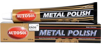

this one??
Sounds exactly what I need and I think available at the autoparts down the street. √
$14 and I can think about a number of uses around here.
Autosol Metal Polish, made in Germany, cleans and polishes metals to a brilliant high shine leaving a protective coating for future protection. The convenient 75ml paste tube offers concentrated cleaning power.
Autosol Metal Polish has been the world market leader in metal polishing since 1929. The paste formula in a 75ml tube offers 10x the polishing power of a liquid equivalent. The Autosol Metal Polish formula polishes: stainless steel, chrome, brass, copper and many more. Autosol Metal Polish removes common problems such as surface rust, discolouration, tarnishing, staining and oxidation with ease. The metal surface is left with an ultra-thin wax coating to prevent the surface from further degradation and corrosion. Autosol Metal Polish is certified by NSF International, a global public health and safety organization, and has been declared safe for use around food processing areas. This product is non-toxic and ammonia free, making it ideal for household, automotive or industrial use. Autosol Metal Polish is made in Germany.

Autosol doesn't change the finish to the naked eye. It will not do anything to the pits that are the source of the rust. Makes them easy to see/feel them though. Properly dealing with the pits is harder without making them far more visible. I wouldnt go further than autosol (or sos).
