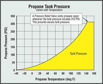

When I used to make spray cans 50+ years ago the propellant was Freon-12 and IIRC the pressure went up 1 psi for each F degree. A closed up car supposedly can hit 140° F. I don't know what the cans are certified for and whether one could end up with an upholstery colour change on a hot day.
Now the propellant is propane.
I did have a can of freeze spray let go one summer day. (They have rupture disks) I couldn't figure how it got on the front seat when I always put it in the back. Then I noticed the ruptured disk in the bottom. Fortunately no upholstery colour change.
