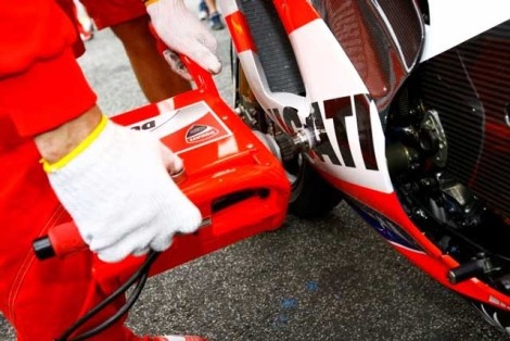

BTW, to answer the OP's question: you can bump start a bike with a slipper clutch. Race bikes with slipper clutches and without starter motors (ie. MotoGP bikes) can only be bump started. Once at race start and again by track marshalls after a crash.
starter-jpg.232783
^-- MotoGP bike being started with an external starter motor.
That starter is turning the crank directly, as opposed to turning it through the rear wheel, transmission, and clutch. A slipper clutch is supposed to be one-way to let the motor spin the transmission, but not the other way around. Same idea as the starter sprag which allows the starter to turn the crank, but doesn't allow the crank to keep the starter motor spinning once running. Don't ask me to explain the rear wheel bump starters, though. Maybe they're not using slippers, or the slippers are tuned for less intervention. :unsure:
