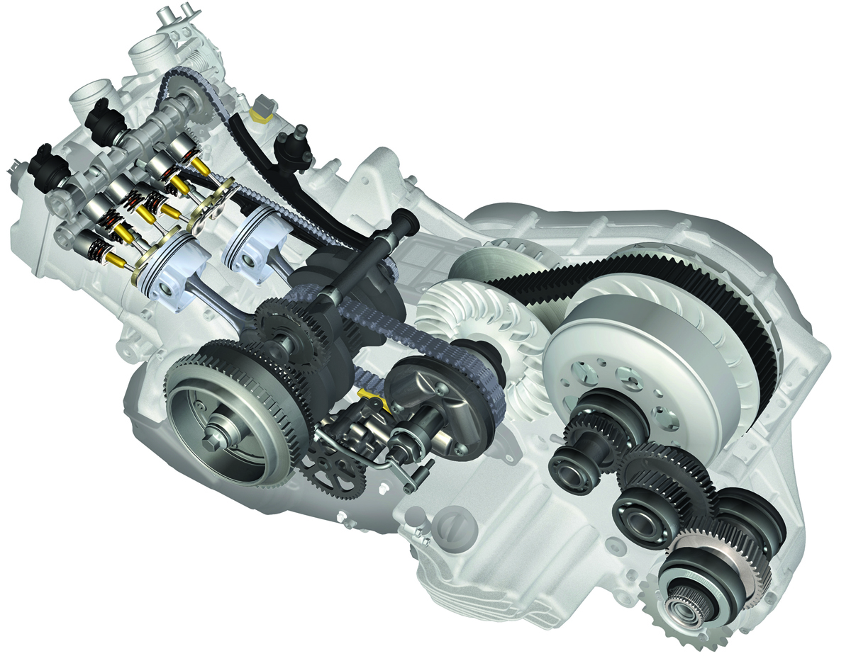

The bikes design does not lend well to performance upgrades, doesn't even appear that you can alter the final drive sprocket size. They use helicoidal gears inside the transmission and anti-vibration counter-balance weights which is costing you a tiny bit of power in the name of reduced vibration. I think you are limited to the acceleration you are already experiencing.
Is just like a snowmobile, keep the rubber drive belt in good condition and that's about the best you can do.
There's no magic here. You might be able to play with ratios a bit, but without a bunch more power I wouldn't expect it to really wake up. I would be surprised if there were ready made kits for that bike, but given enough time, money and effort, a turbo would make a big difference (although you will likely be in uncharted waters and exceed the capacity of something in the drivetrain).
I don't know if it is possible, but the simplest solution is reducing the tire size. That will give you more acceleration at the expense of higher revs at speed and less ground clearance.
PS. Thanks for the pic Trials.
