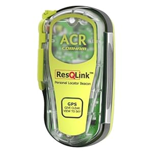

This looks good
[video=youtube;_2eo0rA9hgQ]http://www.youtube.com/watch?v=_2eo0rA9hgQ[/video]
That ACRResquLink video was good - straight forward - will do some followup.
Making sure batteries are full up I would think and the strobe is a good idea. Interesting he mentions Spot as a toy as well.
At $269 that's a decent price tho battery is not user friendly and is expensive to replace- still it also has a very limited "I'm okay" messaged system.
User reviews here worth reading
http://www.amazon.com/ACR-Electronics-ResQLink-Personal-Locator/dp/B0064UE5AG
smaller than a cell phone

$269 for a fall back "come find me" button that last a few years on a sealed battery....that's worth considering given the travel I've got planned both mcycle on both sides of the equator and road tripping in the van to East Coast and next year to Alaska
Nice find, the ACRResquLink is something I have been looking for. I read up on spot and many people complain about it. I always wanted some form of SOS for the back country. When you are days away from cell signal this can save a life.

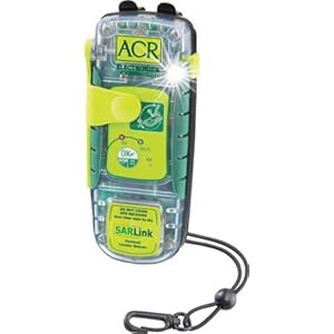

Now this seems to have both worlds covered - messaging and distress...$59 subscription covers the messaging I guess....
[h=2]Product Description[/h] Sarlink 406 gps plb product number: 2883 model number: plb-350 b new features: send im ok messages and gps location maps. Increase the functionality of your plb with optional 406link.com non-emergency messaging service. Head out with confidence. With three levels of integrated signal technology - gps positioning, a powerful 406 mhz signal and 121.5 mhz homing capability - the sarlink quickly and accurately relays your position to a worldwide network of search and rescue satellites, reducing search time and increasing your chances of survival. It?s reliable signaling technology that has saved more than 25,000 lives since 1982. The sarlink broadcasts a unique registered distress signal that not only tells rescuers where you are, but who you are. The onboard gps can fix your position to within 100 meters and then utilizes a powerful 406 mhz signal to relay your distress call to orbiting sar satellites. As local search and rescue is deployed, a separate homing signal and integrated led strobe light guide rescuers to your location. The sarlink is light in weight and small enough to be easily carried in a pack or pocket by skiers, hikers, hunters, kayakers, climbers, pilots, snowmobilers or any other outdoor enthusiast. Performing a full functional self test of the plb?s internal circuitry, battery voltage & power, and 406 mhz transmission gives you the peace of mind knowing your plb will work the moment you need it to the most. Acr exclusive: built-in gps acquisition test mode allows you to test gps functionality up to 12 times over the life of the battery life. Tap in to the same field-tested rescue technology used by the u.s. Military, coast guard, nato special forces and arctic explorers. Features: * no subscription fees * super bright led strobe * on board 66 channel gps * self-test and gps test features * typical performance 35 hours * non-hazmat battery * made in the u.s.a size: 2.25 x 5.88 x 1.29 (5.72 x 14.94 x 3.28 cm) weight: 8.9 oz (258g) with lanyard...
this looks pretty good -
http://www.aviationsurvival.com/ACR-Sarlink-View-Personal-Locator-Beacon-_p_32.html

This ACR PLB unit is $269 with superb reviews and please remember Spot Trackers require a subscription which puts the cost over time much much higher plus the Spot requires batteries so even more cost and risk involved.
[h=1]ACR Electronics ACR ResQLink™ 406 MHz GPS Personal Locator Beacon[/h] by ACR Electronics 4.4 out of 5 stars See all reviews (5 customer reviews) | Like 1329589137 false 1 4 4 3 (4)
$279.99
$269.00

and these units also have the optional messaging available.
ACR ResQLink . 406 MHz GPS Personal Locator Beacon with Optional 406Link.com Service At 4.6 oz, the ResQLink weighs less than a couple of PowerBars®. And topping at just 3.9 inches, it's smaller than the cell phone in your pocket. Small and mighty, the ResQLink is a full-powered, GPS-enabled rescue beacon designed for anglers, pilots and back country sportsmen. With three levels of integrated signal technology - GPS positioning, a powerful 406 MHz signal, and 121.5 MHz homing capability - the ResQLink quickly and accurately relays your position to a worldwide network of search and rescue satellites. A built-in strobe light provides visibility during night rescues. PLBs have been proven tried and true in some of the world's most remote locations and treacherous conditions. Just ask the 400 or so pilots, boaters and back country explorers who were saved by a PLB during a rigorous test program in Alaska. Based in large part on the test results, the federal government approved use of PLBs in the United States in 2003. Even in extreme conditions and situations, the ResQLink activates easily. Just deploy the antenna and press the ON button. With its powerful 66 channel GPS, the ResQLink guides rescuers to within 100 meters or less of your position. And, in the continental U.S., search and rescue personnel are typically alerted of your position in as little as five minutes with a GPS-enabled PLB such as the ResQLink . Two built-in tests allow you to routinely verify that the ResQLink is functioning and ready for use - with the push of a button, you can easily test internal electronics and GPS functionality. Features. Small Size Lightweight Super Bright LED Strobe On Board 66 Channel GPS Self-Test and GPS Test Features Typical Performance of 30 Hrs. Non-Hazmat Battery Wrist Lanyard Made in the U.S.A..
this sums it up for me
I think it's important to site the differences between this unit and a competitor "Spot" which lets you send nifty "I'm OK" messages. Spot is not a SAR 406 MHz Personal Locator Beacon. It is a GPS communicator. The Spot Communicator has been fraught with problems where tracking and personal messages have not been successfully sent. Out of 91 users on REI's website 34 have complained that they have been unable to send messages. This works out to roughly 30% chance that your message didn't make it out. The statistics are even worse for the Spot Smartphone unit. Are these the kind of odds you want in a real emergency?
What I really want is a "Help, come get me" message that will work in the event that I am in an emergency. If I'm in trouble I want my message heard, and for that I'm going to rely on a SAR 406 Mhz beacon! This thing is lightweight and small, and it lets you test it once or twice a year to confirm that it's working. That's what the 12 messages are for, not for idle chit-chat with loved ones.
Yes, it's pricier than the competition at first glance, but there are no yearly subscription fees with this. You buy it once and it's good for years. With the spot you have to pay subscription fees at or over $100 a year. In the long run this ACR is much cheaper.
case closed in my case - gonna stick with the rescue system the pilots and pros rely on.
