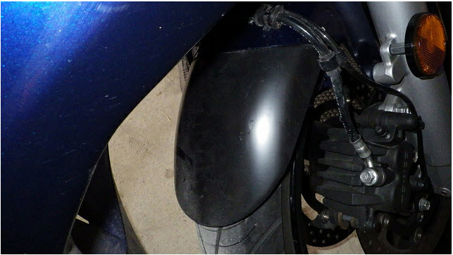

Anyone riding a Suzuki SV650 (any variant) can tell you that the front fender is cut quite high in the back (2), this can allow water and debris to be kicked up into one or both of the radiators (1), as I frequent some of the less travelled roads radiator damage became a concern.

Here is the result.
As you can see it "tightens" the gap between the fender and cowling of the bike.
After having this mounted for a month I have yet to hear a single "ping' of a rock off my radiator or my cowling.
The fit and finish of this product is amazing, aside from the small screw heads it looks like it was part of the original design of this bike. It only took about 30 minutes for the complete installation.
