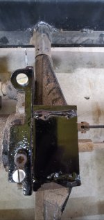

Ok so I'm sure many of you have this lift.its a princess auto 1000 lb air over Hydraulic motorcycle lift ( the yellow one,,) Here's the issue. When I push the release lever the table does not go down smoothly (under load) it kind a jerks down unless I put the release lever down to the max but the rate of decent is quite fast. Second..the table slowly comes down on its own with no load on it. So there is 3 plugs on the cylinder base with adjusting screws under them but nothing in the instructions on which one does what. I called PA customer support and the guy on the phone was great but he also did not have any info on the 3 adjusting screw functions. I need to slow the rate of decent ( under load) and 2 - stop the table from drifting down.
Has anyone had these issues and corrected them ?

Ok. So I loaded the lift with 300 lbs. In the picture are 3 adjusting screw caps. Under the caps are adjusting screws. I removed the 2 outer covers ( bright ones) and turned them 1/2 turn CW. Before turning them in my decent was 7.4 sec. After adjustment time went to 7.9 sec and it's been an hr with no drop. The hex cap screw in the center also has an adjustable screw....I believe it to be the relief....fingers crossed this works but I'll celebrate after I have it fully loaded with the quad ( 800 lbs)

Ok, so here is where we are now. As per the mannual I bled the system. ( hold down the lowering pedal while pumping the manual raise pedal ) the lift now stays in the fully raised position (5 days now) no drop. As far as the lowering speed I turned the center adjusting screw in 2 turns but have not tested it with a full load.
