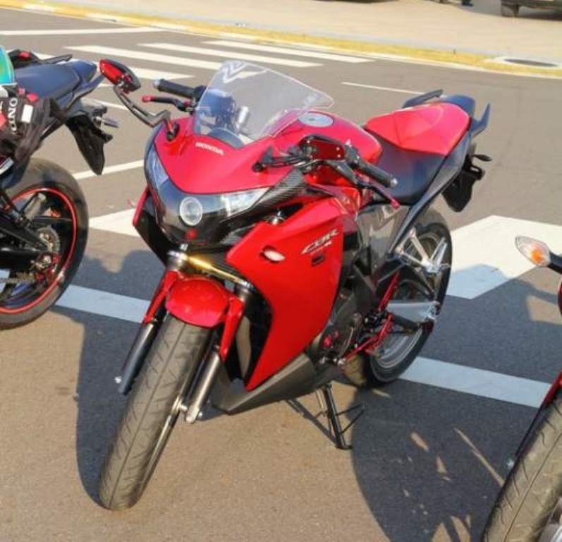

Angel eyes/devil eyes are a huge pain on your bike!! Because your bike doesn't come with projectors (or in your case, a projector) from the factory, to get angel eyes and demon eyes you'll have to install a projector inside the headlight. This involves either baking it in the oven, or fancy work with a heat gun or high end hair dryer (to pry the lens off the headlight). Then you have to pay special attention in getting it sealed perfectly when putting it back together (otherwise your headlights will fog up or get moisture in them all the time, I'm sure you've seen bikes like that) :(
(you can see the front fork brace in that pic, just above the front fender, worthwhile to order from that bikerparts place)
It all depends on how crazy you want to go. Decide for sure if you want angel and demon eyes before you buy your HID kit because you'll need a different kit to work with your projector/angel/demon eyes setup (most projector kits come with the HID kit as well). If you didn't want to risk wrecking your OEM headlight you can buy a replacement headlight from china for $200 (no idea what Honda OEM price is), and do all the modifications to that one then keep your OEM as a spare.
