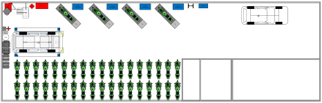

How is garage door and ceiling both 11'2" clear?

There are steel I-beams running the width of the building every 15 feet or so, so the 11'2 measurement is really drive-through clearance. There is up to 13' ceiling height between the beams.
