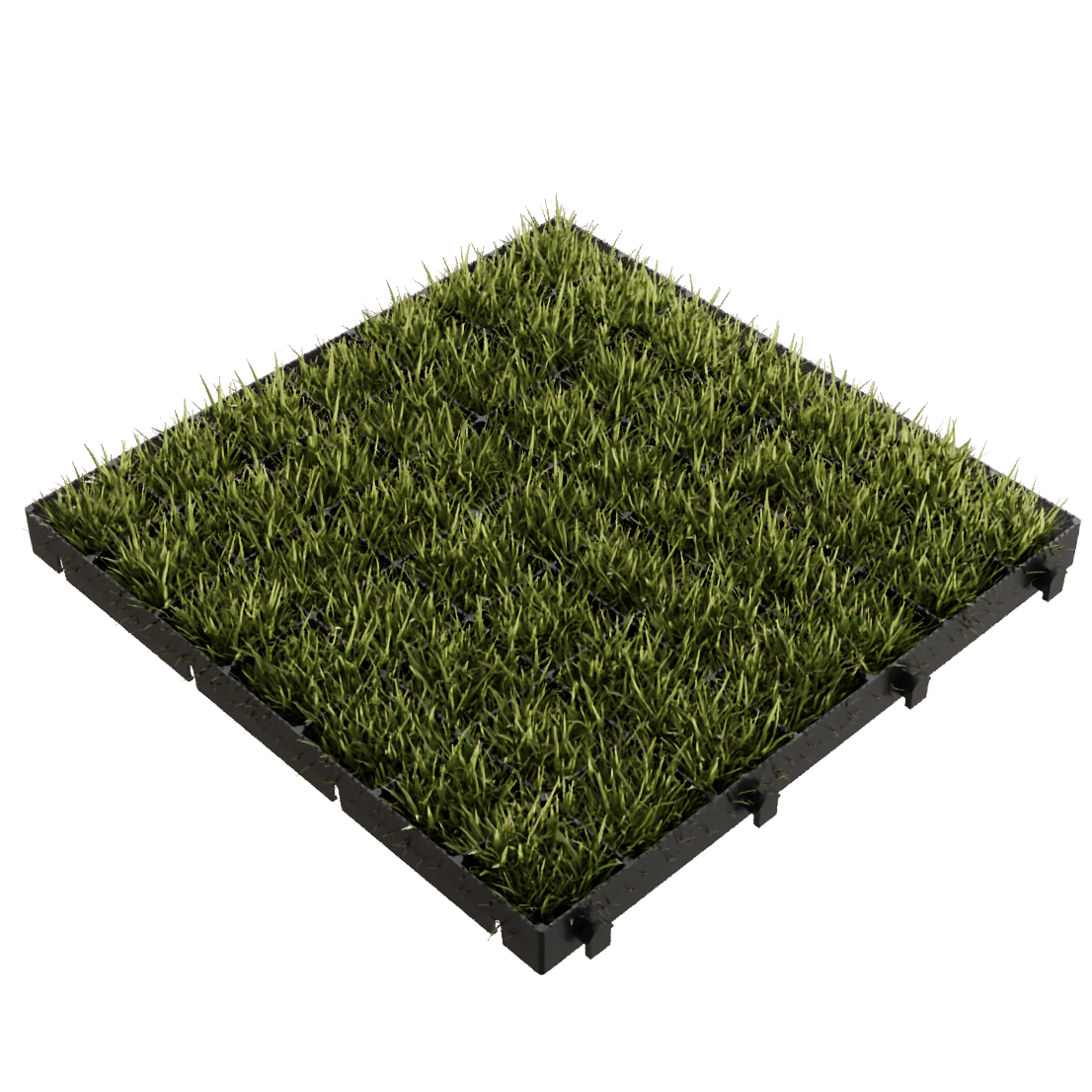

There are grids of ABS you can lay down that let the grass grow through! They kind of disappear into your lawn. They look pretty good!
