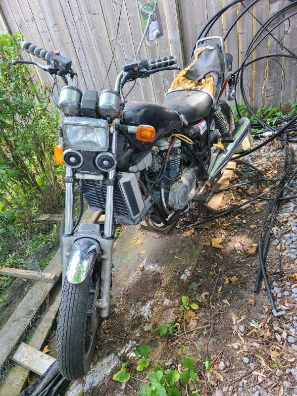

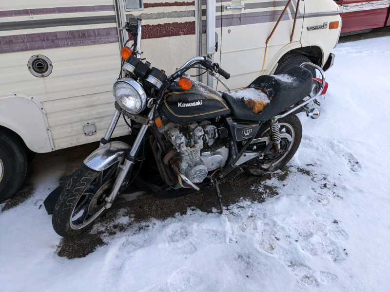

A few $300 beaters on kijiji if you look. Found three but only sharing two.
Weird. I looked myself through all the listings on Kijiji sorting by cheapest first and didn’t find either of those two listings… I need to play with my search parameters I guess, thanks @GVH !
