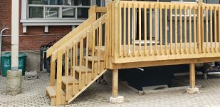

I'm buying a new motorcycle soon and will be keeping it indoors (I don't have a garage and storing it outside is not an option as I will not be getting it plated/insured until September as I have a Quebec license that I can only change for a full license in September)
I need to take it up a patio (all the loading ramps I've seen online are 7-9 feet long, that looks long enough to cover the length of the stairs but I'm worried about the angle at the top of the stairs)

Attached a photo of the stairs in question
The stairs at the front of my house are lower but I live in a ground floor unit and there's a common entrance and my own door is exactly at a right angle to the main entrance door and I don't think it would be able to fit through. Or maybe it might..

If you can pay someone to help you out, that bike would be super-easy to get up those stairs with an extra pair of arms and legs.
If you really can't find someone, then buy a ramp. Make sure it's rated to carry the weight of the bike, some of the cheaper ones are only rated to hold 250 lb dirtbikes. Also look for one with an arched top, so your bike doesn't bottom out when it clears the top step.

If your steps are standard height (7" rise), then 5 steps will be 35", which is almost exactly the height of most pick-up truck tailgates. If you use a ramp that can get a motorcycle up a pick-up truck bed then it will handle that top step no problem.
The longer your ramp, the less of an angle that top of the ramp will be when it meets the top step. Again, arched top will help greatly clearing the top step.
Just went out and measured it and you're right. It was about 38 inches, thanks a lot for the help ?. I guess i'm getting a ramp! Thought that pickup trucks had lower loading though

Have you looked at one of those track stands with castors to get it through the front? They let you turn the bike around the front wheel, but do add a bit of length which may be problematic.
As for a ramp, my main concern would be the width of the stairs if you're planning to do it on your own. When I load a bike into a truck, I run two narrow ramps, one for the bike and one for me to stand on beside the bike. Is there room for that on the stairs? Failing that, it might be worth looking at one of the bi- or tri-fold ATV/sled ramps (depending on width) so you can ride it up while being able to put a foot down for stability. Just make sure you strap the ramp to a lower step to stop it sliding out halfway up...
One other consideration is making sure you have enough room at the bottom to get the bike lined up onto a ramp. It's out of the frame of your picture, but if you use a narrow width ramp, you'll want to get the bike square on before the front wheel hits the ramp or it can be a nightmare lining it up properly. Just something to think about if you're looking at 7' vs 9'.
