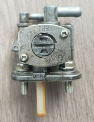

Oh, interesting. The petcock on that bike apparently has "PRI", "ON" and "OFF" positions: Ninja 250: Petcock Problems
You might have to look closely to see the "OFF" position. The markings are often confusing.
The "PRI" position on the petcock is to "PRIME" the carb for starting. That is to say, it allows the carb to fill with gas, which is useful if it's been sitting for a long time. You normally want to switch the petcock to "ON" after you've got it started and the engine warms up and is running smoothly.
One possible drawback of leaving the petcock in the "PRI" position for a long time is that it could flood the carbs (too much gas), making it impossible to start. If it is flooded it will likely smell strongly of gas while you're trying to start it. There should be large bolts on the very bottom of the carbs which will allow you to drain the excess gas out of the carbs to solve this problem, but be very sure that the petcock is in the OFF position if you try this, otherwise the entire tank can drain itself onto your garage floor.
If you don't want to mess with the carb drains, an easier experiment is to switch the petcock to "OFF" and then try to start the bike. If it really is flooded, the starter turning the engine over will cause the excess gas to eventually be pulled out of the carb and the bike will no longer be flooded. This might take a minute or two. It's possible that your battery might die before all the excess gas is gone, though.
edit: there are a lot of EX250 variations. Looks like your petcock could indeed have only PRI and ON positions (random ebay pic). Even if you don't have an OFF position, you can usually clear flooding by holding the throttle open 50% while you thumb the starter.

Short answer: In normal usage you'll always want to leave the petcock in the ON position.
Long answer: The petcock on that bike is vacuum operated, meaning that when it's in the ON position gas will only flow into the carbs when the engine is turning over, either by the starter or by normal running. You can test that this is working correctly by switching the petcock to ON and pulling off the rubber tube between the petcock and the carbs. After the little bit of residual gas in the tube drains out, no more gas should flow out of the tank. Now thumb the starter button. Gas should start to flow out of the tube again (use a cup or something so you don't end up covered in gas), and the flow of gas should stop when you stop thumbing the starter.
The PRI setting bypasses that whole vacuum thing, meaning that gas will flow unimpeded from the petcock into the carbs regardless of whether the engine is turning over or not. If you pull the rubber tube off between the petcock and the carb while the petcock is in the PRI position, the entire gas tank will eventually drain out. You probably don't want to do this. You should normally only need to use the PRI position if the carb bowls are empty. It's common to drain the carbs in the fall when you store the bike for the winter, for example, so you'd use PRI in the spring to fill them back up. You should only need to put it in the PRI position for less than a minute to fill the bowls.
