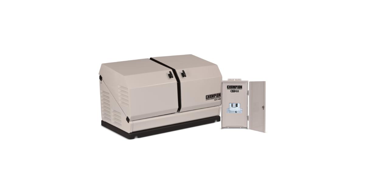

If you really want to do it "right", spend a little more and get their 8.5kW home standby
runs on propane or NG, has on board trickle charger, includes fully automatic transfer switch/panel, super quiet, peace of mind 10 year warranty (vs 3 year for portable model) Why run it for an hour when this thing will turn on an off by itself when ever the utility power cuts out and comes back on. Total peace of mind, and worry free back up power.
Ultimate in convenience.
I have them in stock with the lowest price in Ontario.
runs on propane or NG, includes fully automatic transfer switch, super quiet, 10 year warranty
NO need to haul out a bulky genny, worry about theft, start the generator, leaving in rain, bad gas, worry about cold starter issues. This baby can handle the cold and start automatically even whe you are not home. When you leave the cottage, just put it in the off position.
Could you please PM me a quote for just the unit and then a typical installation estimate separately? Is the 10-year warranty still valid if I install it myself, and by myself I mean I move it into position, then hire an electrician and a licensed gas installer to run the lines?
I'll pm you tmrw when I'm in the office.
They sell them at Canadian tire to public so anybody can buy and install them and the Warranty applies to everyone no matter who installs. Tech support will even guide you if you have questions during installation. They are great.

4200 at canadian tire, 3500 from me. brand new in crate, pick up in burlington
Do you do installations too, or just sell the units?
That's damn good pricing Sunny.
Interesting that one is dual fuel lpg/nat gas which makes sense for standby. Most dual fuel are gasoline/lpg. I suspect some buyers see dual fuel and make the wrong assumptions.
We do lots of installations, but never north of toronto (far). The Champions are pretty easy to install, any competent electrician can do it. And like I said, tech support is a phone call away if you need help.
Every major brand home standby generator comes dual fuel NG/propane. I'm pretty sure ALL of them (champions and generac for sure) come from the factory NG ready, but can easily be swapped to propane.
We have a 8500 champion standby no issues in 9 years except the starter doesn't always engage the first time but always does on the second try unit is at 130 hrs now. Had to change the batteries last year but that was easy.
