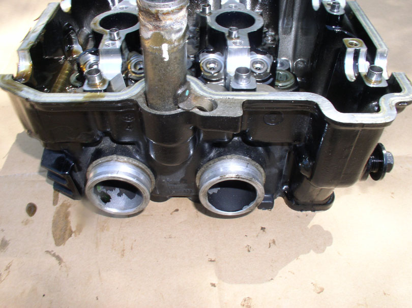

This is the same pipe right?
If your sure that the hose clamp is tight then I'm gonna say that the o-ring in the cylinder head is probably shot.
yea, thats the one. To get to the o-ring will I have to remove the top cover and where exactly is it located? Is it a wear and tear item or do you have any idea if I can get it warrantied?
You need to remove the cylinder head cover. Which means you'll have to disconnect your clean air stuff and possibly your radiator hoses, which will require draining part of your cooling system.
The o-ring is located under the steel pipe that the hose is attached to... between the intake ports. Here's a better pic (although it is from the 2nd gen ex250):
It shouldn't be a wear and tear item... but without knowing who your dealer its difficult to say if they will honor the warranty without funny business. If you turn your bike on and get it up to temperature, you should be able to see coolant leaking or spraying out of there if that is indeed the source of the leak.
