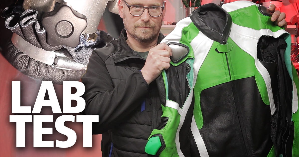

As a new rider there are tons of gear to choose from. What ever you choose, be it an informed decision.
Credits John Milbank is the consumer editor for BikeSocial | Motorcycle News, Reviews & Features | Bennetts and Paul Varnsverry is a technical director at Home - PVA-PPE
watch
read
I'm sure not a racer, but my experience with Pakistani leathers is that they're some of the best quality leather you can buy. It looks like in this review the failures are mainly due to the ignorance of the manufacturer, not really knowing enough about safety standards. For the average street rider these leathers appear to be okay. Obviously if you're a sport rider who frequents the track, investing in proper name brand leathers is wise. Riding GP style with a $400 set of leathers well, I think they're testing here tells you why that's folly.
Personally I would not street ride in leathers. The coefficient of friction on leather is much lower than textile, so the slide will be longer.
Great on the track wher ther are no poles, trees, curbs and the traffic all heading in the same direction. The opposite on the street.
